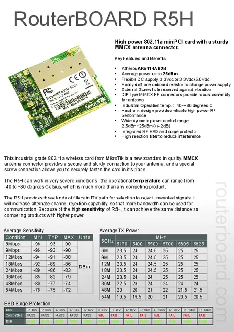

This industrial grade 802.11a wireless card from MikroTik is a new standard in quality. MMCX
antenna connector provides a secure and sturdy connection to your antenna, and a special
screw connection allows you to securely fasten the card in it’s place.
The R5H can work in very severe conditions - the operational temperature can range from
-40 to +80 degrees Celsius, which is much more than any competing product.
The R5H provides three kinds of filters in RX path for selection to reject unwanted signals. It
will increase alternate channel rejection capability, so that more bandwidth can be used for
communication. Because of the high sensitivity of R5H, it can achieve the same distance as
competing products with higher power.
| Details | |
| Product code | R5H |
| 5GHz | Yes |
| 802.11 Turbo mode support | Yes |
| Chipset | AR5414A B2B |
| Connector | MMCX |
| Format | miniPCI |
| Max power consumption | 1.6A |
| Output power | 25dBm |
| Tested ambient temperature | -50℃ to +70℃ |
