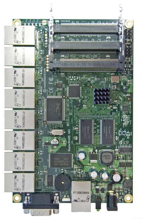

    RB493 300MHz CPU, 64MB RAM, 9x Ethernet, 3xminiPCI, RouterOS L4
    Discontinued
    The RB493 has nine ethernet ports and three miniPCI slots, it also has a switch chip, so the ethernet ports of your choice can be grouped together to make it act as a switch.
    RB493 includes RouterOS - the operating system, which will turn this powerful system into a highly sophisticated router, firewall or bandwidth manager.
