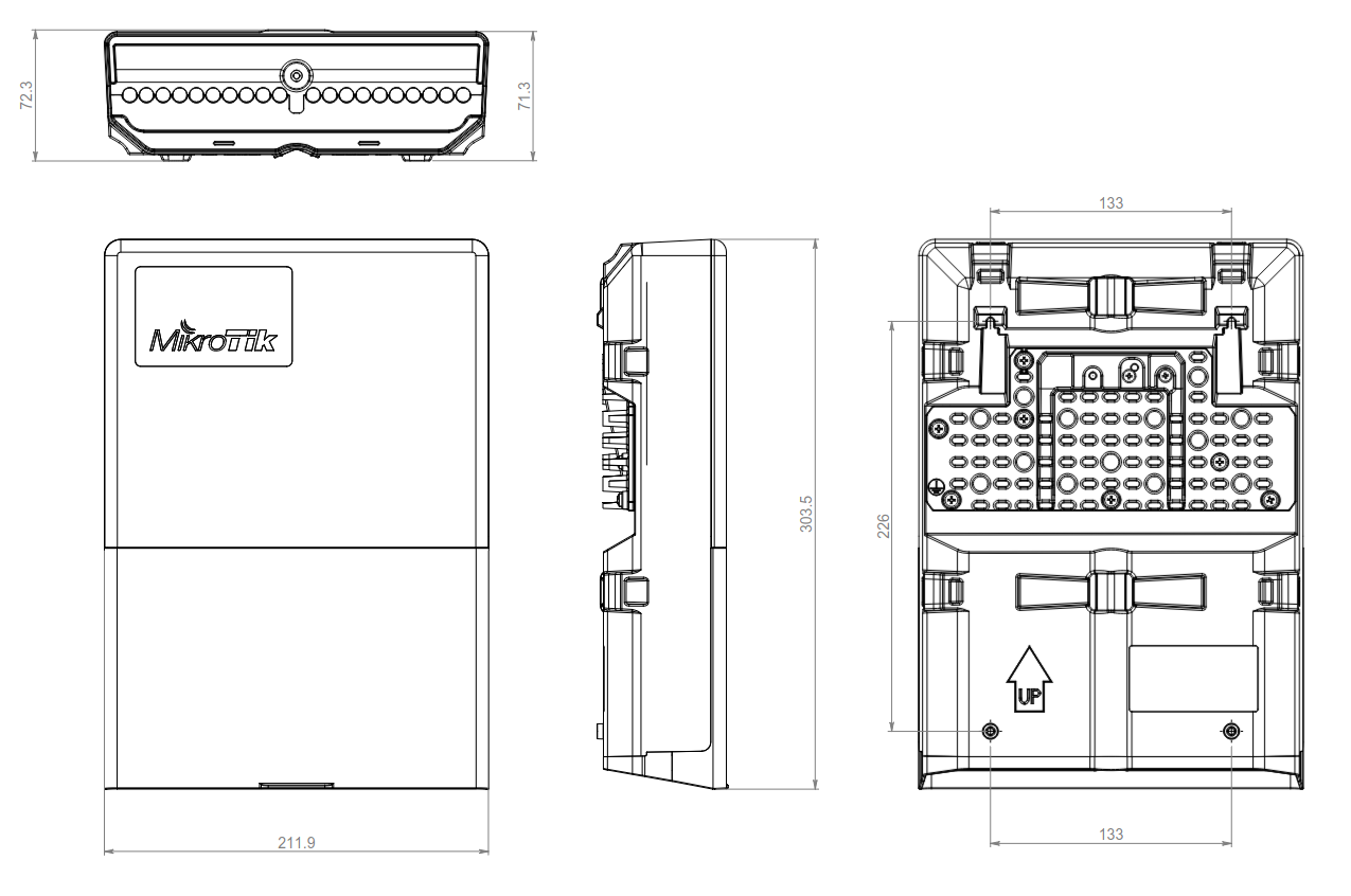

  • Dimensions 303.5 x 211.9 x 71.3/72.3 (left/right) mm
