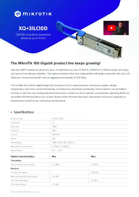

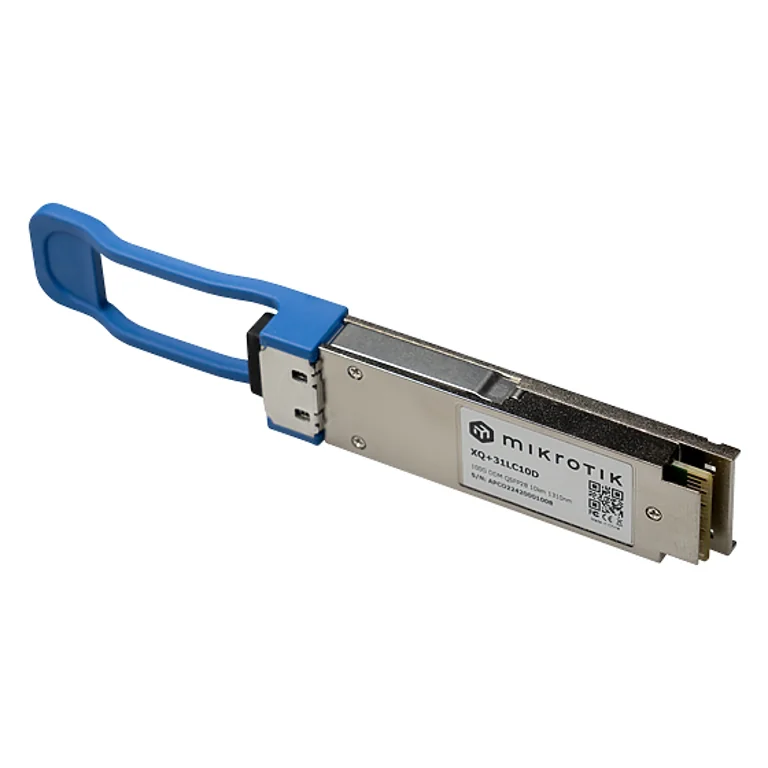

Add this QSFP module for distances up to 10 kilometers to your CCR2216, CRS504 or CRS518 setups and enjoy real speed and ultimate reliability. This optical module offers four independent full-duplex channels with up to 25 Gbps per channel bandwidth and an aggregate bandwidth of 100 Gbps.
The module has built-in digital diagnostic functions such as optical power, transceiver supply voltage, temperature, laser bias current monitoring, and other key parameter monitoring. These options can be helpful not only to alert the user during abnormal transceiver activity but also if specific customizable operating limits are exceeded. Monitoring allows you to plan ahead, make informed decisions and predict necessary upgrades or maintenance based on the transceiver performance.

  • Product code XQ+31LC10D
  • Suggested price $349.00
  • Connector Dual LC UPC
  • Data Rate 100G
  • Distance 10km
  • Format QSFP28
  • Mode SM
  • Wavelength 1296nm, 1300nm, 1305nm, 1309nm
