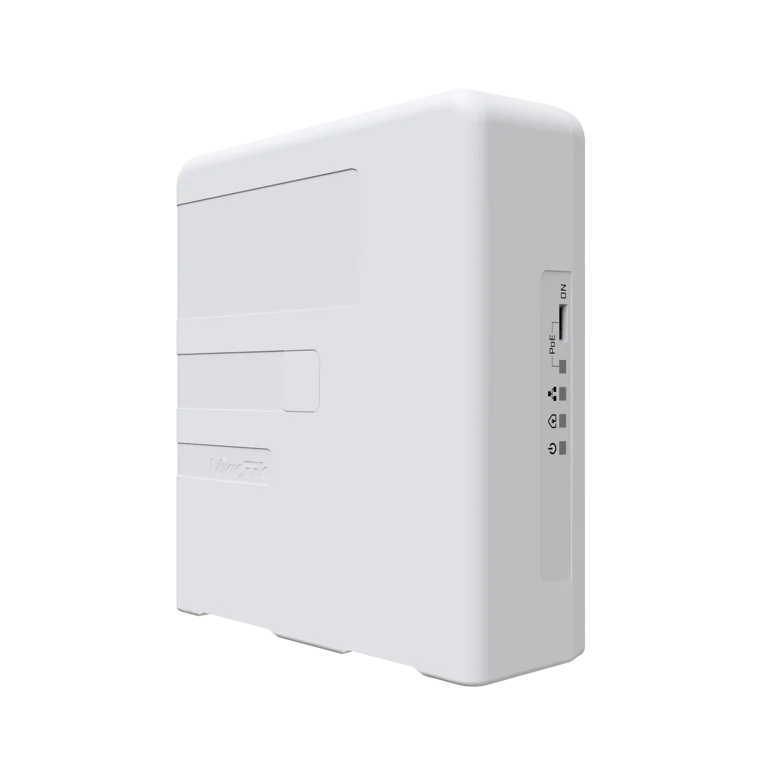

PWR-LINE PRO (PL7510Gi) is a smart accessory to your existing network for places, where your signal or your cable is unable to reach. Usually data over power-lines would be capped at 100 Mbps, but with PWR-LINE PRO you can reach speed up to 600 Mbps!
Simply plug this device directly into one of the LAN ports of your MikroTik router and add another one somewhere further in your premises. They will link together seamlessly through the power lines – now you have a perfectly stable network connection in that tricky spot where cable management would be maddening! You can install up to eight PWR-LINE devices to further build your network.
This product works best with other PL75xx series products, but is backwards compatible with PL64xx and PL74xx as well. PWR-LINE PRO – don’t let the cables limit you!

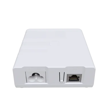

  • Product code PL7510Gi
  • Suggested price $59.00
  • AC input range 100-240
  • Tested ambient temperature -40°C to 60°C
  • PLC chipset QCA7550
  • PoE out Passive PoE
  • Low voltage PoE-Out current limit 350 mA
  • Max total out (A) 350 mA
  • Max power consumption 14 W
  • Max power consumption without attachments 5 W
  • 10/100/1000 Ethernet ports 1
