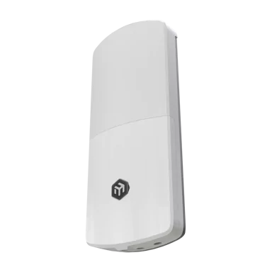

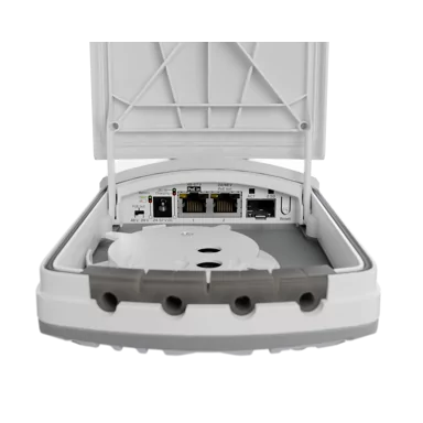

A weatherproof Fiber-to-Copper converter with 2.5G SFP and 2x Gigabit Ethernet ports, including PoE-out on Ether2. Its integrated battery keeps links stable during short power interruptions, preventing unnecessary renegotiations and device reboots.
802.3af/at (PoE Output), great for CCTV cameras!
IP67 weatherproof enclosure
2x Gigabit Ethernet
2.5G SFP
Fiber is fast. Fiber is reliable.
Until the power starts misbehaving.
At the network edge, it is rarely the fiber that fails. It is unstable power, brownouts, short outages, and voltage drops that trigger renegotiations, device reboots, and unnecessary support tickets. The FTC21-ups is built to save you some major headaches when dealing with unreliable power sources

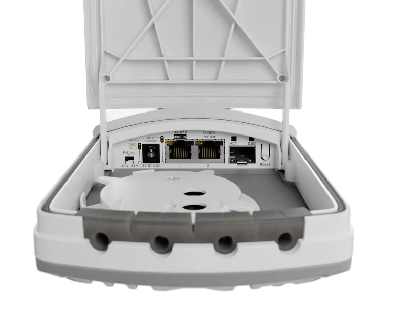

Powering
  • Number of DC inputs 2 (DC jack, PoE-IN)
  • DC jack input Voltage 24-57 V
  • Max power consumption 28 W
  • Max power consumption without attachments 3 W
  • PoE in 802.3af/at
  • Cooling type Passive
  • PoE in input Voltage 48-57 V

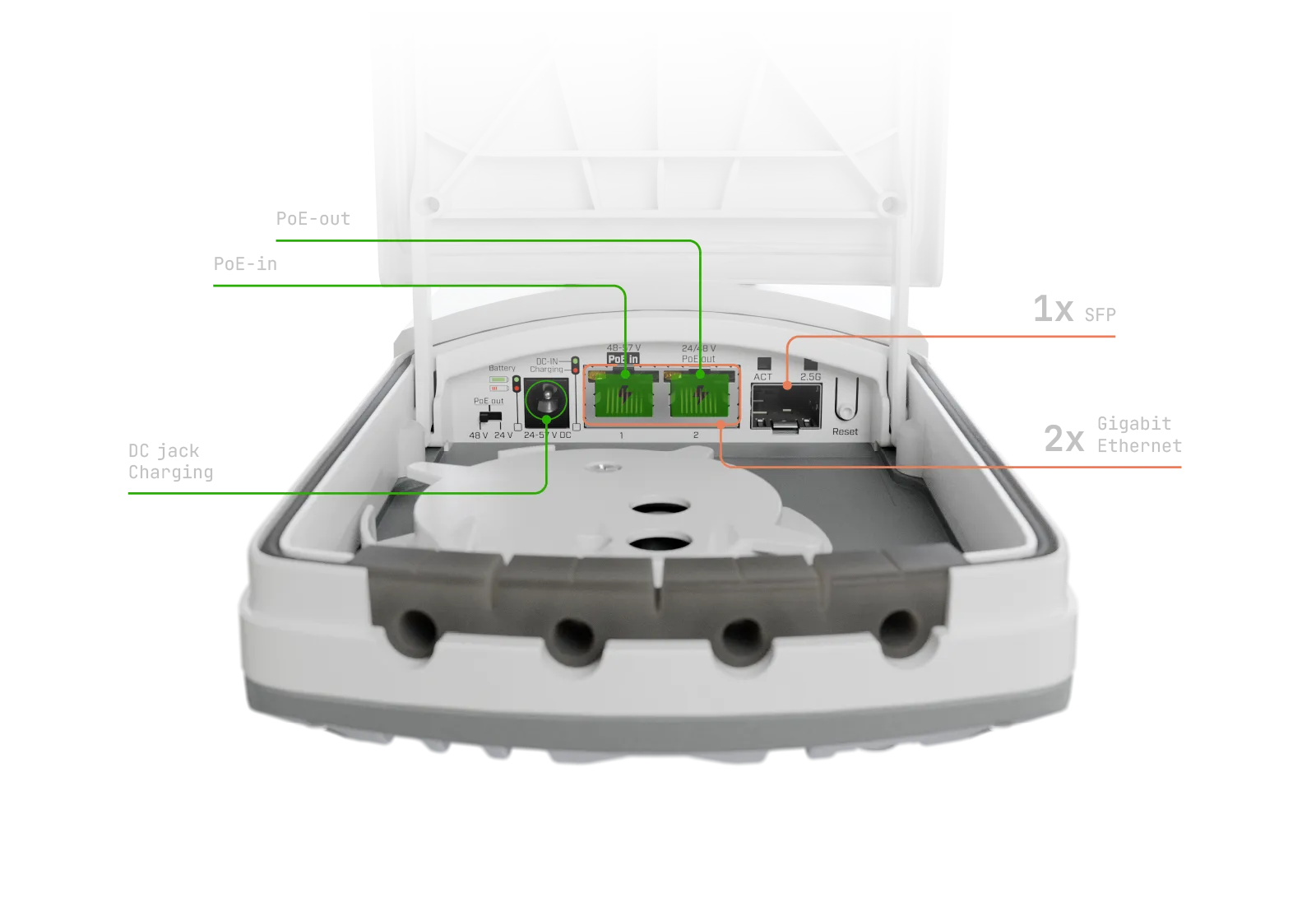

PoE-out
  • PoE-out ports Ether2
  • PoE out Passive PoE up to 57V
  • Low voltage PoE-Out current limit 0.625 A
  • High voltage PoE-Out current limit 0.315 A
  • Max total out (A) 0.625 A
  • Total output current 0.625
  • Total output power 15
Ethernet
  • 10/100/1000 Ethernet ports 2
  • Number of 1G Ethernet ports with PoE-out 1
Fiber
  • SFP ports 1 (2.5G supported)
