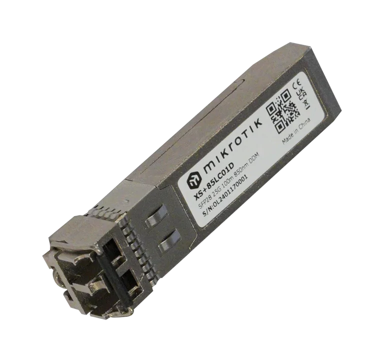

A cost-effective 1.25G SFP, 10G SFP+ and 25G SFP28 module for shorter distances: up to 100 meters in full- duplex 25 Gigabit mode. Its compatibility with different speeds and the affordable price makes it a versatile solution for various setups of any scale - including bestsellers like the RB5009, CCR2116, netPower series or a variety of CRS and CSS switches.
The module has built-in digital diagnostic functions such as optical power, transceiver supply voltage, temperature, laser bias current monitoring, and other key parameter monitoring. These options can be helpful not only to alert the user during abnormal transceiver activity but also if specific customizable operating limits are exceeded. Monitoring allows you to plan ahead, make informed decisions and predict necessary upgrades or maintenance based on the transceiver performance.
Specification
Specifications
  • Product code XS+85LC01D
  • Suggested price $59.00
  • Connector Dual LC UPC
  • Data Rate 1G / 10G / 25G
  • Distance 100m
  • Format SFP / SFP+ / SFP28
  • Mode MM
  • Tested ambient temperature -40°C to 85°C
  • Wavelength 850nm
