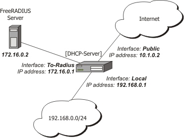

It is also possible to hand out leases for DHCP clients using the RADIUS server, here are listed the parameters for used in RADIUS server.
Access-Request:
- NAS-Identifier - router identity
- NAS-IP-Address - IP address of the router itself
- NAS-Port - unique session ID
- NAS-Port-Type - Ethernet
- Calling-Station-Id - client identifier (active-client-id)
- Framed-IP-Address - IP address of the client (active-address)
- Called-Station-Id - name of DHCP server
- User-Name - MAC address of the client (active-mac-address)
- Password - ""
Access-Accept:
- Framed-IP-Address - IP address that will be assigned to client
- Framed-Pool - ip pool from which to assign ip address to client
- Rate-Limit - Datarate limitation for DHCP clients. Format is: rx-rate[/tx-rate] [rx-burst-rate[/tx-burst-rate] [rx-burst-threshold[/tx-burst-threshold] [rx-burst-time[/tx-burst-time][priority] [rx-rate-min[/tx-rate-min]]]]. All rates should be numbers with optional 'k' (1,000s) or 'M' (1,000,000s). If tx-rate is not specified, rx-rate is as tx-rate too. Same goes for tx-burst-rate and tx-burst-threshold and tx-burst-time. If both rx-burst-threshold and tx-burst-threshold are not specified (but burst-rate is specified), rx-rate and tx-rate are used as burst thresholds. If both rx-burst-time and tx-burst-time are not specified, 1s is used as default. Priority takes values 1..8, where 1 implies the highest priority, but 8 - the lowest. If rx-rate-min and tx-rate-min are not specified rx-rate and tx-rate values are used. The rx-rate-min and tx-rate-min values can not exceed rx-rate and tx-rate values.
- Ascend-Data-Rate - tx/rx data rate limitation if multiple attributes are provided, first limits tx data rate, second - rx data rate. If used together with Ascend-Xmit-Rate, specifies rx rate. 0 if unlimited
- Ascend-Xmit-Rate - tx data rate limitation. It may be used to specify tx limit only instead of sending two sequental Ascend-Data-Rate attributes (in that case Ascend-Data-Rate will specify the receive rate). 0 if unlimited
- Session-Timeout - max lease time (lease-time)

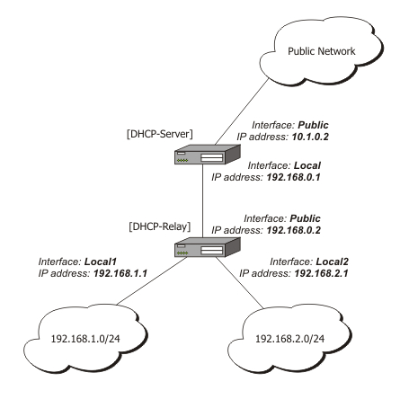

DHCP Relay
Submenu level: /ip dhcp-relayDescription
DHCP Relay is just a proxy that is able to receive a DHCP request and resend it to the real DHCP server
Property Description
delay-threshold (time; default: none) - if secs field in DHCP packet is smaller than delay-threshold, then this packet is ignoreddhcp-server (text) - list of DHCP servers' IP addresses which should the DHCP requests be forwarded tointerface (name) - interface name the DHCP relay will be working onlocal-address (IP address; default: 0.0.0.0) - the unique IP address of this DHCP relay needed for DHCP server to distinguish relays:Notes
DHCP relay does not choose the particular DHCP server in the dhcp-server list, it just send the incoming request to all the listed servers.
Example
To add a DHCP relay named relay on ether1 interface resending all received requests to the 10.0.0.1 DHCP server:
[admin@MikroTik] ip dhcp-relay> add name=relay interface=ether1 \
\... dhcp-server=10.0.0.1 disabled=no
[admin@MikroTik] ip dhcp-relay> print
# NAME INTERFACE DHCP-SERVER LOCAL-ADDRESS
0 relay ether1 10.0.0.1 0.0.0.0

Dynamic Addressing, using DHCP-Relay
Let us consider that you have several IP networks 'behind' other routers, but you want to keep all DHCP servers on a single router. To do this, you need a DHCP relay on your network which relies DHCP requests from clients to DHCP server.
This example will show you how to configure a DHCP server and a DHCP relay which serve 2 IP networks - 192.168.1.0/24 and 192.168.2.0/24 that are behind a router DHCP-Relay.
IP addresses of DHCP-Server:
[admin@DHCP-Server] ip address> print Flags: X - disabled, I - invalid, D - dynamic # ADDRESS NETWORK BROADCAST INTERFACE 0 192.168.0.1/24 192.168.0.0 192.168.0.255 To-DHCP-Relay 1 10.1.0.2/24 10.1.0.0 10.1.0.255 Public [admin@DHCP-Server] ip address>
IP addresses of DHCP-Relay:
[admin@DHCP-Relay] ip address> print Flags: X - disabled, I - invalid, D - dynamic # ADDRESS NETWORK BROADCAST INTERFACE 0 192.168.0.1/24 192.168.0.0 192.168.0.255 To-DHCP-Server 1 192.168.1.1/24 192.168.1.0 192.168.1.255 Local1 2 192.168.2.1/24 192.168.2.0 192.168.2.255 Local2 [admin@DHCP-Relay] ip address>
To setup 2 DHCP Servers on DHCP-Server router add 2 pools. For networks 192.168.1.0/24 and 192.168.2.0:
/ip pool add name=Local1-Pool ranges=192.168.1.11-192.168.1.100 /ip pool add name=Local1-Pool ranges=192.168.2.11-192.168.2.100
[admin@DHCP-Server] ip pool> print # NAME RANGES 0 Local1-Pool 192.168.1.11-192.168.1.100 1 Local2-Pool 192.168.2.11-192.168.2.100 [admin@DHCP-Server] ip pool>
Create DHCP Servers:
/ip dhcp-server add interface=To-DHCP-Relay relay=192.168.1.1 \ address-pool=Local1-Pool name=DHCP-1 disabled=no /ip dhcp-server add interface=To-DHCP-Relay relay=192.168.2.1 \ address-pool=Local2-Pool name=DHCP-2 disabled=no
[admin@DHCP-Server] ip dhcp-server> print Flags: X - disabled, I - invalid # NAME INTERFACE RELAY ADDRESS-POOL LEASE-TIME ADD-ARP 0 DHCP-1 To-DHCP-Relay 192.168.1.1 Local1-Pool 3d00:00:00 1 DHCP-2 To-DHCP-Relay 192.168.2.1 Local2-Pool 3d00:00:00 [admin@DHCP-Server] ip dhcp-server>
Configure respective networks:
/ip dhcp-server network add address=192.168.1.0/24 gateway=192.168.1.1 \ dns-server=159.148.60.20 /ip dhcp-server network add address=192.168.2.0/24 gateway=192.168.2.1 \ dns-server 159.148.60.20
[admin@DHCP-Server] ip dhcp-server network> print # ADDRESS GATEWAY DNS-SERVER WINS-SERVER DOMAIN 0 192.168.1.0/24 192.168.1.1 159.148.60.20 1 192.168.2.0/24 192.168.2.1 159.148.60.20 [admin@DHCP-Server] ip dhcp-server network>
Configuration of DHCP-Server is done. Now let's configure DHCP-Relay:
/ip dhcp-relay add name=Local1-Relay interface=Local1 \ dhcp-server=192.168.0.1 local-address=192.168.1.1 disabled=no /ip dhcp-relay add name=Local2-Relay interface=Local2 \ dhcp-server=192.168.0.1 local-address=192.168.2.1 disabled=no
[admin@DHCP-Relay] ip dhcp-relay> print Flags: X - disabled, I - invalid # NAME INTERFACE DHCP-SERVER LOCAL-ADDRESS 0 Local1-Relay Local1 192.168.0.1 192.168.1.1 1 Local2-Relay Local2 192.168.0.1 192.168.2.1 [admin@DHCP-Relay] ip dhcp-relay>
IP Address assignment, using FreeRADIUS Server
Let us consider that we want to assign IP addresses for clients, using the RADIUS server.
We assume that you already have installed FreeRADIUS. Just add these lines to specified files:
users file:
00:0B:6B:31:02:4B Auth-Type := Local, Password == ""
Framed-IP-Address = 192.168.0.55
clients.conf file
client 172.16.0.1 {
secret = MySecret
shortname = Server
Configure Radius Client on RouterOS:
/radius add service=dhcp address=172.16.0.2 secret=MySecret
[admin@DHCP-Server] radius> print detail
Flags: X - disabled
0 service=dhcp called-id="" domain="" address=172.16.0.2 secret="MySecret"
authentication-port=1812 accounting-port=1813 timeout=00:00:00.300
accounting-backup=no realm=""
Setup DHCP Server:
Create an address pool:
/ip pool add name=Radius-Clients ranges=192.168.0.11-192.168.0.100
Add a DHCP server:
/ip dhcp-server add address-pool=Radius-Clients use-radius=yes interface=Local \ disabled=no
Configure DHCP networks:
/ip dhcp-server network add address=192.168.0.0/24 gateway=192.168.0.1 \ dns-server=159.148.147.194,159.148.60.20
Now the client with MAC address 00:0B:6B:31:02:4B will always receive IP address 192.168.0.55.
