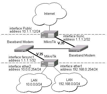

MikroTik router to MikroTik router
Let us consider the following network setup with two MikroTik routers connected to a leased line with baseband modems:
The interface should be enabled according to the instructions given above. The IP addresses assigned to the synchronous interface should be as follows:
[admin@MikroTik] ip address> add address=1.1.1.1/32 interface=farsync1 \
\... network=1.1.1.2 broadcast=255.255.255.255
[admin@MikroTik] ip address> print
  #   ADDRESS            NETWORK         BROADCAST       INTERFACE
  0   10.0.0.254/24      10.0.0.254      10.0.0.255      ether2
  1   192.168.0.254/24   192.168.0.254   192.168.0.255   ether1
  2   1.1.1.1/32         1.1.1.2         255.255.255.255 farsync1
[admin@MikroTik] ip address> /ping 1.1.1.2
1.1.1.2 64 byte ping: ttl=255 time=31 ms
1.1.1.2 64 byte ping: ttl=255 time=26 ms
3 packets transmitted, 3 packets received, 0% packet loss
round-trip min/avg/max = 26/27.6/31 ms
Note that for the point-to-point link the network mask is set to 32 bits, the argument network is set to the IP address of the other end, and the broadcast address is set to 255.255.255.255. The default route should be set to the gateway router 1.1.1.2:
[admin@MikroTik] ip route> add gateway 1.1.1.2
[admin@MikroTik] ip route> print
 #      DST-ADDRESS        PREF-SRC        G GATEWAY         DISTANCE INTER...
 0 A S  0.0.0.0/0                          r 1.1.1.2         1        farsync1
 1 ADC  10.0.0.0/24        10.0.0.254      r                 0        ether2
 2 ADC  192.168.0.0/24     192.168.0.254   r                 0        ether1
 3 ADC  1.1.1.2/32         1.1.1.1         r                 0        farsync1
The configuration of the MikroTik router at the other end is similar:
[admin@MikroTik] ip address> add address=1.1.1.2/32 interface=fsync \
\... network=1.1.1.1 broadcast=255.255.255.255
  0   10.1.1.12/24       10.1.1.12       10.1.1.255      Public
  1   1.1.1.2/32         1.1.1.1         255.255.255.255 fsync
[admin@MikroTik] ip address> /ping 1.1.1.1
1.1.1.1 64 byte ping: ttl=255 time=31 ms
1.1.1.1 64 byte ping: ttl=255 time=26 ms

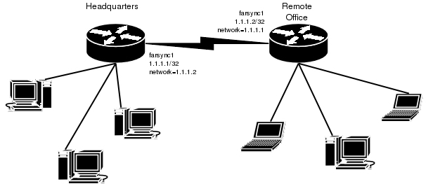

MikroTik router to MikroTik router P2P using X.21 line
Consider the following example:
The default value of the property clock-source must be changed to internal for one of the cards. Both cards must have media-type property set to X21.
IP address configuration on both routers is as follows (by convention, the routers are named hq and office respectively):

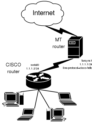

MikroTik router to Cisco router using X.21 line
Assume we have the following configuration:
The configuration of MT router is as follows:
[admin@MikroTik] interface farsync> set farsync1 line-protocol=cisco-hdlc \
\... media-type=X21 clock-source=internal
[admin@MikroTik] interface farsync> enable farsync1
[admin@MikroTik] interface farsync> print
  0  R name="farsync1" mtu=1500 line-protocol=cisco-hdlc media-type=X21
       clock-rate=64000 clock-source=internal chdlc-keepalive=10s
       frame-relay-lmi-type=ansi frame-relay-dce=no
  1 X  name="farsync2" mtu=1500 line-protocol=sync-ppp media-type=V35
       clock-rate=64000 clock-source=external chdlc-keepalive=10s
[admin@MikroTik] interface farsync> /ip address add=address=1.1.1.1/24 \
\... interface=farsync1
The essential part of the configuration of Cisco router is provided below:
interface Serial0
 ip address 1.1.1.2 255.255.255.0
 no ip route-cache
 no ip mroute-cache
 no fair-queue
ip classless
ip route 0.0.0.0 0.0.0.0 1.1.1.1

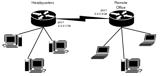

MikroTik router to MikroTik router using Frame Relay
The default value of the property clock-source must be changed to internal for one of the cards. This card also requires the property frame-relay-dce set to yes. Both cards must have media-type property set to X21 and the line-protocol set to frame-relay.
Now we need to add pvc interfaces:
[admin@hq] interface pvc> add dlci=42 interface=farsync1
[admin@hq] interface pvc> print
  #    NAME                                                 MTU  DLCI INTERFACE
  0 X  pvc1                                                 1500 42   farsync1
Similar routine has to be done also on office router:
[admin@office] interface pvc> add dlci=42 interface=farsync1
[admin@office] interface pvc> print
Finally we need to add IP addresses to pvc interfaces and enable them.
On the hq router:
[admin@hq] interface pvc> /ip addr add address 2.2.2.1/24 interface pvc1
[admin@hq] interface pvc> /ip address print
  0   10.0.0.112/24      10.0.0.0        10.0.0.255      ether1
  1   192.168.0.1/24     192.168.0.0     192.168.0.255   ether2
  2   2.2.2.1/24         2.2.2.0         2.2.2.255       pvc1
[admin@hq] interface pvc> enable 0
and on the office router:
[admin@office] interface pvc> /ip addr add address 2.2.2.2/24 interface pvc1
[admin@office] interface pvc> /ip address print
  1   2.2.2.2/24         2.2.2.0         2.2.2.255       pvc1
[admin@office] interface pvc> enable 0
Now we can monitor the synchronous link status:
[admin@hq] interface pvc> /ping 2.2.2.2
2.2.2.2 64 byte ping: ttl=64 time=20 ms
2.2.2.2 64 byte ping: ttl=64 time=21 ms
4 packets transmitted, 4 packets received, 0% packet loss
round-trip min/avg/max = 20/20.5/21 ms
