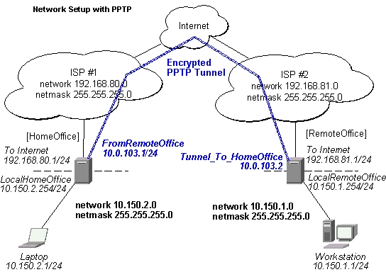

PPTP Router-to-Router Secure Tunnel Example
The following is an example of connecting two Intranets using an encrypted PPTP tunnel over the Internet.
There are two routers in this example:
Each router is connected to a different ISP. One router can access another router through the Internet.
To add a secure Tunnel between the HomeOffice and RemoteOffice routers, add an identical user and password with the group 'ppp' to both the HomeOffice and RemoteOffice router:
[RemoteOffice] user> add name remote password remote group ppp
[HomeOffice] user> add name remote password remote group ppp
Add a PPTP static server interface to the HomeOffice router:
[HomeOffice] interface pptp-static-server> print
0   name: FromRemoteOffice client-address: 192.168.81.1 pap: no chap: no
    ms-chapv2: yes encryption: required mtu: 1460 mru: 1460 idle-timeout: 0
    session-timeout: 0 local-address: 10.0.103.1 remote-address: 10.0.103.2
Add a PPTP client to the RemoteOffice router:
[RemoteOffice] interface pptp-client> print
0   name: Tunnel_To_HomeOffice mtu: 1460 mru: 1460 pap: no chap: no
    ms-chapv2: yes encryption: required user: remote connect-to: 192.168.80.1
    idle-timeout: 0 session-timeout: 0
Thus, a PPTP tunnel is created between the routers. This tunnel is like an Ethernet point-to-point connection between the routers with IP addresses 10.0.103.1 and 10.0.103.2 at each router. It enables 'direct' communication between the routers over third party networks.
To route the local Intranets over the PPTP tunnel – add these routes:
[HomeOffice] > ip route add dst-address 10.150.1.0/24 gateway 10.0.103.2
[RemoteOffice] > ip route add dst-address 10.150.2.0/24 gateway 10.0.103.1
Test the PPTP tunnel connection:
[RemoteOffice]> /ping 10.0.103.1
10.0.103.1 pong: ttl=255 time=3 ms
ping interrupted
3 packets transmitted, 3 packets received, 0% packet loss
round-trip min/avg/max = 3/3.0/3 ms

To avoid this, two static routes should be added to each of the routers before creating the PPTP tunnel:
[HomeOffice] > ip route add dst-address 192.168.81.1/32 gateway 192.168.80.254
[RemoteOffice] > ip route add dst-address 192.168.80.1/32 gateway 192.168.81.254
To bridge a LAN over this secure tunnel, please read the 'EoIP' section of the manual. To set the maximum speed for traffic over this tunnel, please the 'Queues' section.
